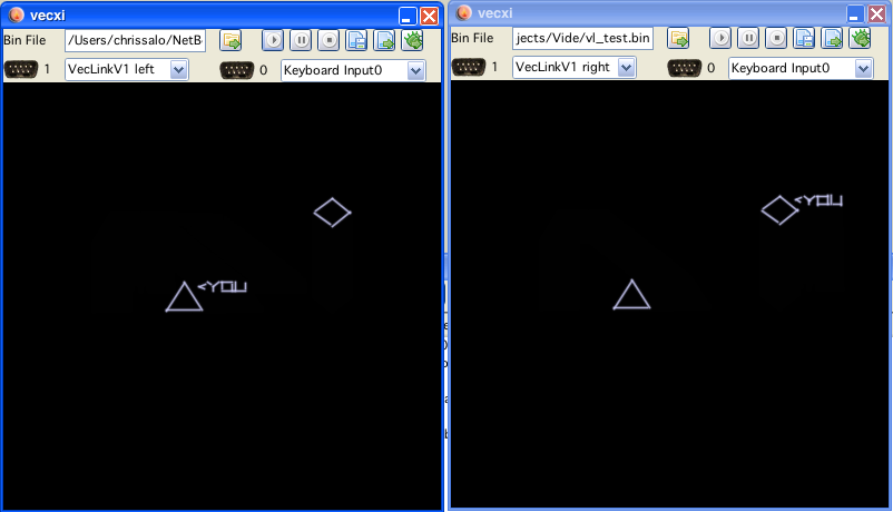

Let me remind you, that there is no way to "automatically" configure vide to run two vecx instances, you have to start two instances manually:
Manually meaning:
go to the main menu and start a vecx
select the veclink binary you would like to play
press start
select for port 0 the input device you would like to use
select for port 1 the veclink cable you would like to use, start with the "left" side (although it does not really matter which side is plugged in first)
repeat the above process for a second vecx instance,
for port 1 select the "other side" (right?) of the same veclink cable
VecLink example
