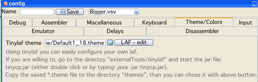

The following image contains nearly all features:
As a seperate lonely feature - the TAB size that is used within Vedi, is als configured here.
build a laf
In the background you see the configuration tab "Theme/Colors". On this tab you can:
chose which tinylaf "theme" you would like to use
go to the tinylaf theme editor
and configure the colors of the syntax highlight for vedi

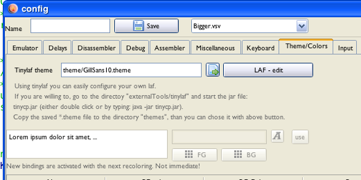

One aspect that does not immediately spring to mind is the above mentioned "sizes". Using different themes it is possible to increse/decrease with just a few clicks the font size of the entire vide application.
You are invited to experiment!
Note!
Size of the editor font is selected directly via the editor!
Example:
Smaller
Larger
