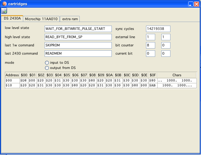

In general the emulation are two state machines,
one lowlevel "machine" which regulates bit manipulations and waits for timings slots and such.
and one highlevel machine which emulates the commands
The highlevel uses the lowlevel machine and is "called" back from it when it is finished.
Input/output is basically done via the lineIn and lineOut functions. Both functions in itself do not trigger any further actions.
All steps of emulation are "triggered" from the "step" function. The step function should be called EVERY emulated cycle.
The step function is basically the lowLevel statemachine, which on occassion triggers the highlevel.
You can view current emulation status by opening a "cartridge" window (in dissi type "carti").
emulation view
