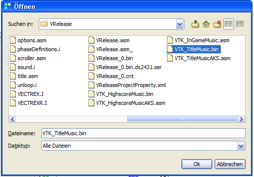

If you have a file available, you can easily add the file to your project. Place the mousecursor over the project name and press the right mouse button.
add a file to the project
Chose "add file"... and navigate in the resulting file choser to the file of your desire.
add a bin file
By chosing a file - the file is copied to the project directory and is NOW available.

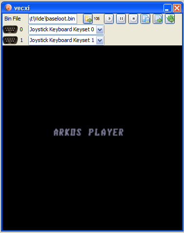

The generated sources are accompanied by an example Arkos tracker player routine.

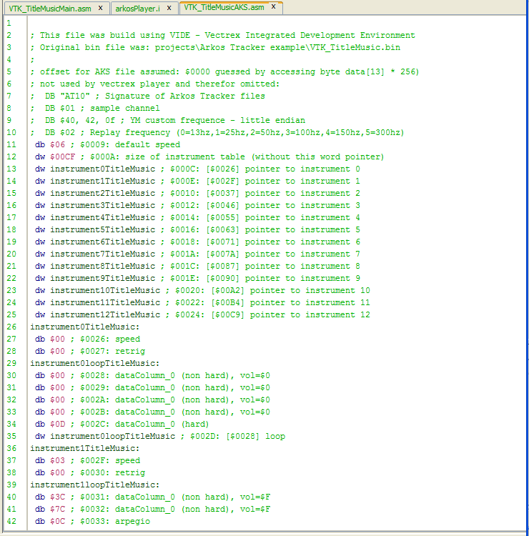

VTK_TitleMusicAKS.asm
a file with the actual data

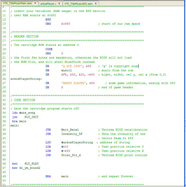

VTK_TitleMusicMain.asm
a "main" file, with an example vectrex runnable "cartridge" file
A vectrex playable binary file can be generated by setting the generate "VTK_TitleMusicMain.asm" file as the main file in the project.
Arkos player

example main
track data
