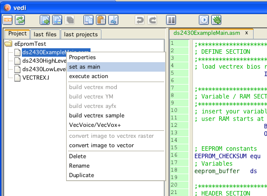

In order for the example to be runable select the created file: "ds2430ExampleMain.asm", right click to show the popup-Menu and select "set as Main".
With this you tell the current project that the selected file should be treated as the main file, meaning - this file must be assembled.
changing main file

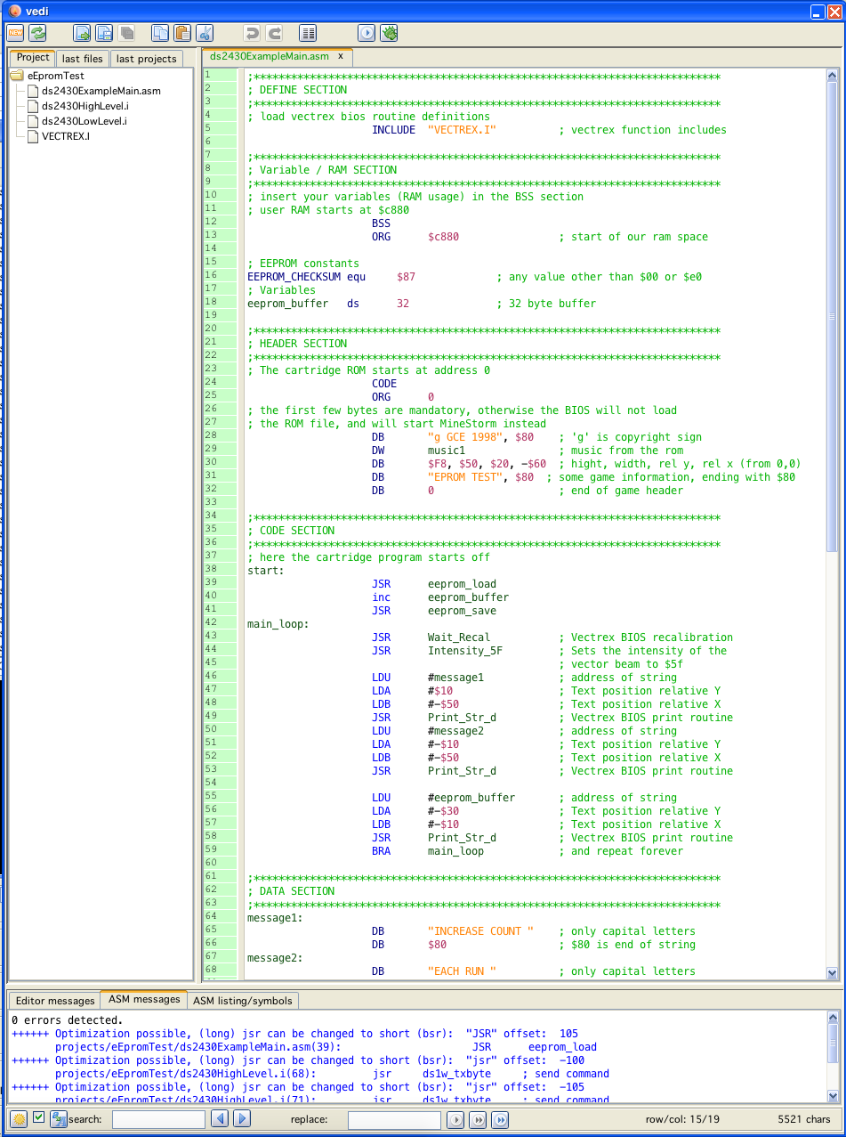

There only two methods and one variable worth mentioning of the included files:
you must declare a RAM space of 32 consecutive bytes, in the example the name for that space is "eeprom_buffer" (that buffer should beforehand be filled with a "standard" setting, in case the eEprom is first used and thus empty)
upon starting the cartridge, you read the eEprom "JSR eeprom_load" (transfer 32 bytes to the above mentioned buffer - or upon first access reset the eEprom with the default values)
upon changing data in the buffer, that you wish to persist call "JSR eeprom_save".
That is all.

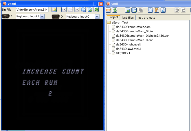

The example program just increases a counter each time it is started.
(technically in vide the savestate is saved in a file with the name of the "bin" concatinated with "ds2430.ser" - java serialization)
running
