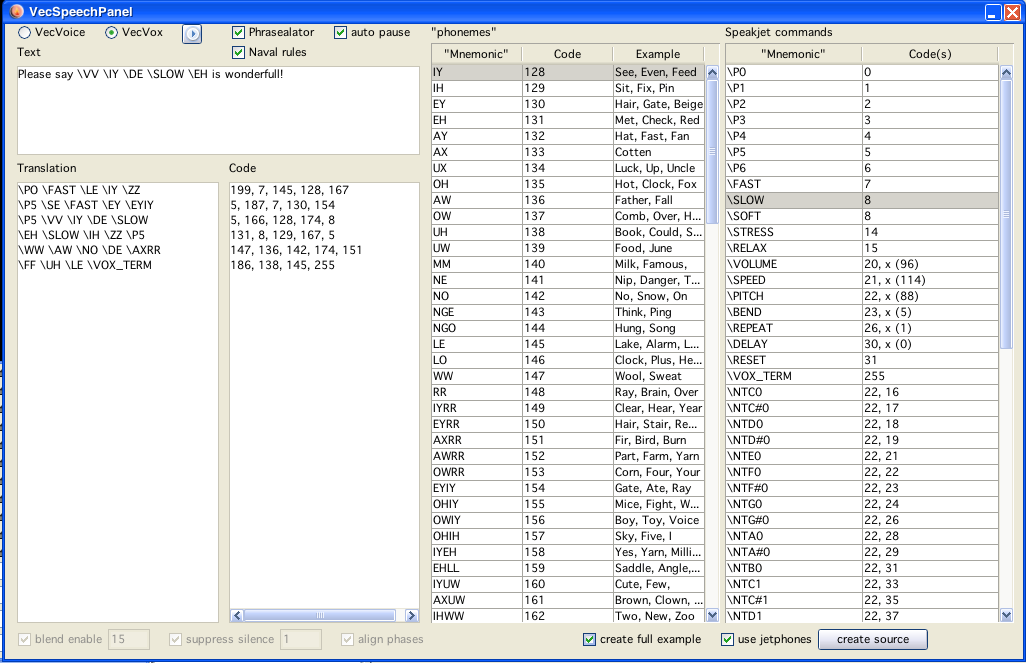

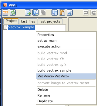

VecVoice/VecVox editing and building code is generated in vedi, using the popup on the project file tree. By chosing the entry "VecVoice/VecVox+" the appropriate dialog is displayed (see also the vedi→VecVoice/VecVox+ documentation).
VecVoice/VecVox
speech dialog
Exiting the above dialog with "create source" will (...hm...) create sources in the current project directory.
For the generated files the names are always the same, to use them in your own programs you have to change them to your likings. The speech dialog must be closed manually after generating the code.

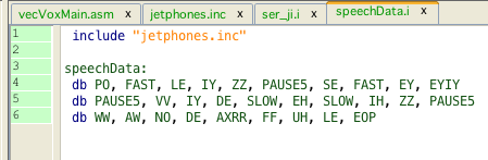

speechData.i
a file with the actual speech data

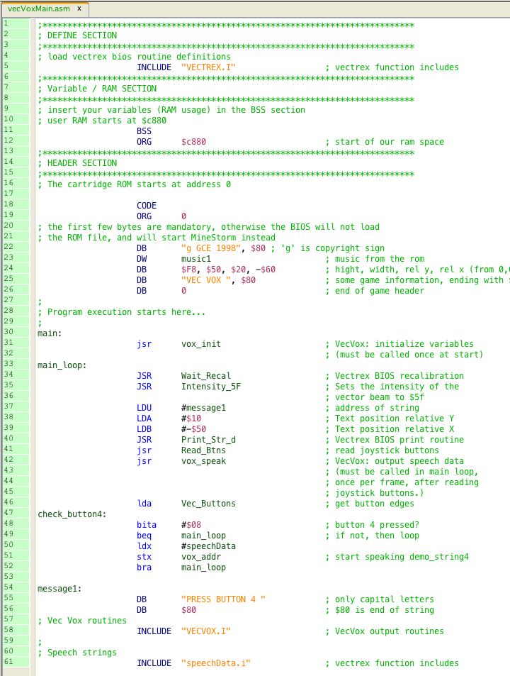

vecVoxMain.asm
a "main" file, with an example vectrex runnable "cartridge" file

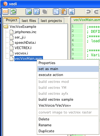

A vectrex playable binary file can be generated by setting the generate vecVoxMain.asm file as the main file in the project.
set example player as main

the user needs only to access two subroutines:
vox_init once at the start of the program to initialize serial communciation of joyport 1
vox_speak to actually output data to the vecvox
the output of data to vecvox is initialized by storing the address of the speech data to the RAM variable: vox_addr
