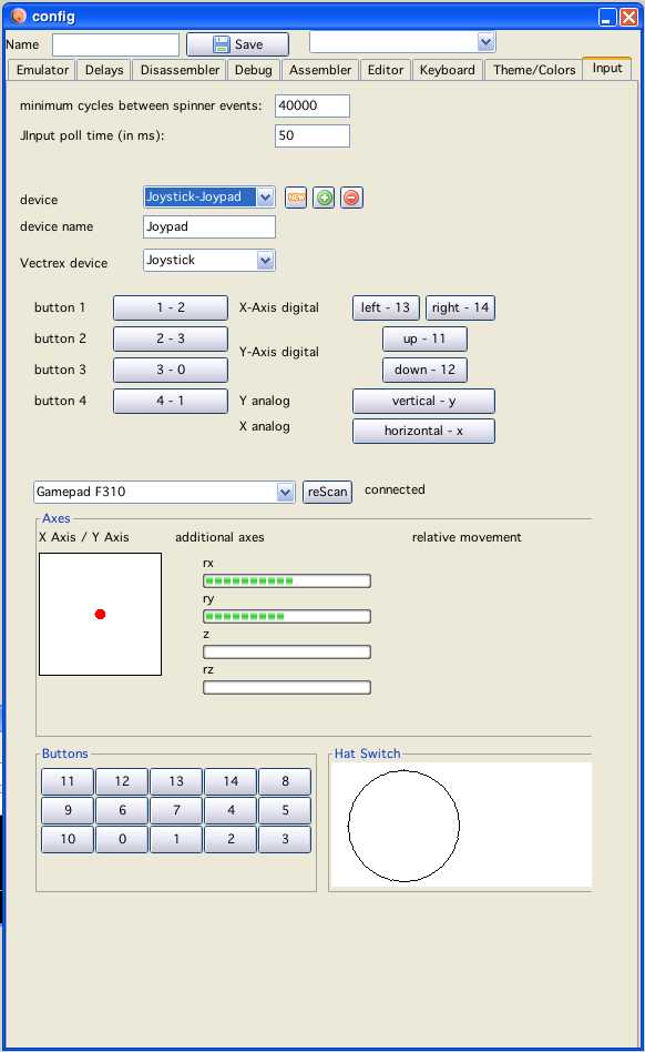

input settings
Here you can configure additional input settings for different inout "hardware" for use with the emulator. The code is based on the "JInput" library.
The tab is split into two halfs, the upper half representing the vectrex "side" the lower half representing the input device parameters.
There are at the moment two types of vectrex input types:
Joystick
spinner (like atari driving paddle)
Pressing one button on the vectrex half enables "input chosing" - pressing (or moving) the actual hardware of the selected "real" input device - connects the two sides.
When the mouse is chosen as an input device - to configure buttons "other" than the left mouse button:
click button with left mousebutton and HOLD the left mouse button pressed
click the other button you want to use, after that release the left mouse button
the configuration is activated by a "button press" event and finished by the first "button release" event
thus the first button that is released is taken as the configured input button
Pressing
saves the configuration (after a valid name was entered).
Upon the next start of a vecxi window, the new input settings will be appear in the Joyport selection boxes.
Devices will be remembered for the next vide-sessions, however should the device not be available, it won't appear in the combobox.
