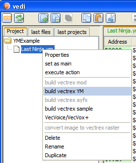

YM file conversion and play code is generated in vedi, using the popup on the project file tree. By chosing the entry "build vectrex YM" the dialog is displayed. (see also the vedi→YM-Conversion documentation(s))
The popup menu is only activated while a ym file is selected in the current project. You have to download (or create ym) files befor you can convert them (in the configuration section under edit you can download a few thousand [wait a little for the download to finish]).

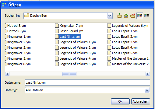

Chose "add file"... and navigate in the resulting file choser to the file of your desire.
add a ym file
By chosing a file - the file is copied to the project directory and is NOW available.
build vectrex YM
Selecting "build vectrex YM" opens the - dialog: (which is explained in "vedi→YM-Conversion II")

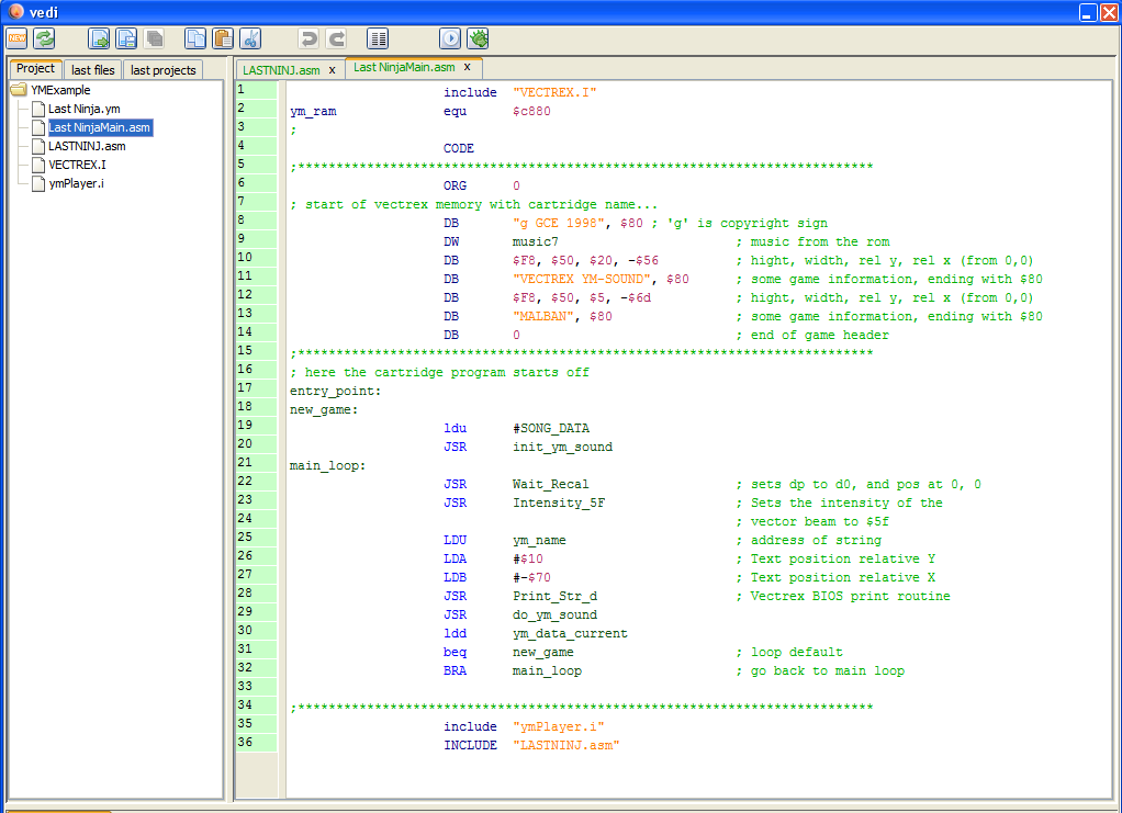

Last NinjaMain.asm
a "main" file, with an example vectrex runnable "cartridge" file

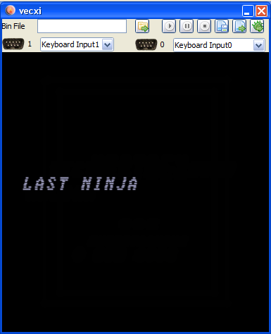

A vectrex playable binary file can be generated by setting the generate "Last NinjaMain.asm" file as the main file in the project.

The format and the actual display routines are documented in the source code - and quite extensibly in the above other mentioned pages.
Just a few bullet points...
the initialization routine is called init_ym_sound and expects the ym-sound data structure in register U. This must be called befor a new ym-file is to be played.
the actual ym routine is called do_ym_sound that routine should be places somewhere in your main loop
the generated ym player respects the settings of the dialog (like skipping certain registers, or playing uncompressed ym data)
example main
example ym player
