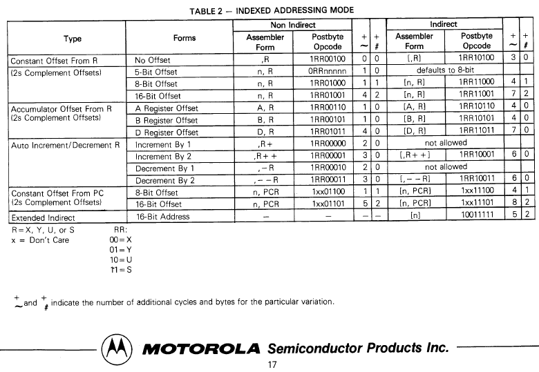

indexed adressing modes
Dissi generates data (instead of code), if the postbyte of an indexed instruction is not as described in the above official table.

        if ( ((pb>>4) & 0x6) != 0)
                        1XX? ????
                        X bits can be anything,
                        asmj converts "sta <$30,pc"
                        to "ec 8c 30"
                        which is correct
                        but "ec ec 30"
                        but "ec dc 30"
                        but "ec bc 30" are also correct, but only the first 100% ressembles old binary
                        therefor the below three variants must be converted to DB, with comment not to convert to code!
                        this is true for both 16 bit or 8 bit variant!
                return incorrectDisassembleFoundAt(currentPC, "Ambiguous pc index addressing, postbytes bit 5 and 6 are non zero (assi generates 0).");
