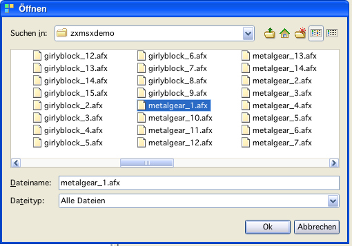

add a file to the project
Chose "add file"... and navigate in the resulting file choser to the file of your desire.
add a ayfx file
By chosing a file - the file is copied to the project directory and is NOW available.

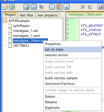

build vectrex ayfx
Selecting "build vectrex ayfx" converts the ayfx files directly (no dialog, although you can edit ayfx files, for this you must use the ym-dialog):
The sources will be created in the current project directory.

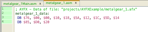

metalgear 1.asm
a file with the actual data

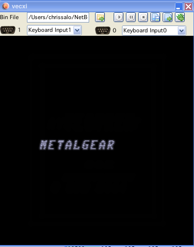

a "main" file, with an example vectrex runnable "cartridge" file
A vectrex playable binary file can be generated by setting the generate "metalgear 1Main.asm" file as the main file in the project.

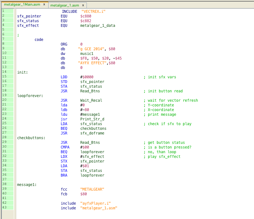

the AYFX routines were written by Richard Chadd, I have not modified them, they were released as a facebook posting for other vectrex interested people
for initialization following variables should be cleared: sfx_pointer (16 bit) and sfx_status (8 bit).
for playing a sound effect the address of the effect must be put into the sfx_pointer variable and a "1" into the sfx_status variable
in the main loop a subroutine sfx_doframe must be called, as long as the status is not 0
the provided example does only play one ayfx at a time and this hardcoded in channel 3 of the PSG chip
to use the other two sound registers, the routine has to be expanded
example main
ayfx data
ayfx example
